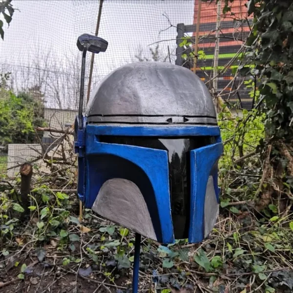

Has anyone tried Rub n Buff with a clear lacquer ? I've used it on a cosplay and it looks good if you want "old chrome". Might be an expensive option though as comes in tiny tubes.

Rub n buff. I'd never heard if it so went a googling.
Seems to be a wax based product. Maybe a bit like clear shoe polish with metalic particles.
Can't see something like acrylic lacquer working. Can't paint on wax.

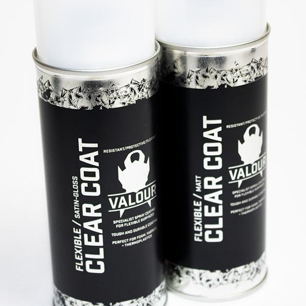

You are probably correct. I covered mine (it was on a Jango Fett helmet made out of EVA foam) with a clear coat that was specific for covering acrylic paint and there were no ill effects.
the paint used was :
