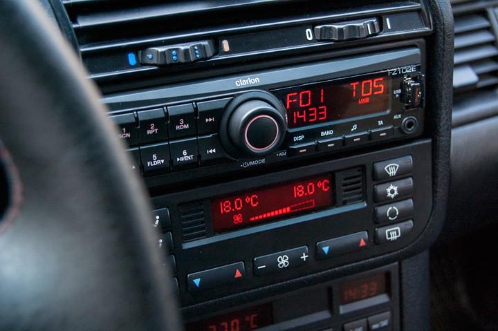

I just recently replaced a very ugly looking aftermarket Blaupunkt I found on my Z with a very OEM Looking Clarion FZ102E. It's mechless meaning it only reads USB sticks and has an aux in, so it mounts very shallow...and it's light.
I am very happy with it and the most amazing thing is that it has a OEM look (big volume knob, chunky buttons) and the illumination is a 10/10 perfect match with the BMW amber color. I think Clarion made it purposely for BMW youngtimers.
I have attached a picture of it on my Z3 dash and another one on the E36 where you can better see the illumination.
Retail price is around 100euros, I found it mint by a guy for less than half.
I think you hit on a great match with this unit. It certainly has the old styling so lacking in so many units these days!! JIM
