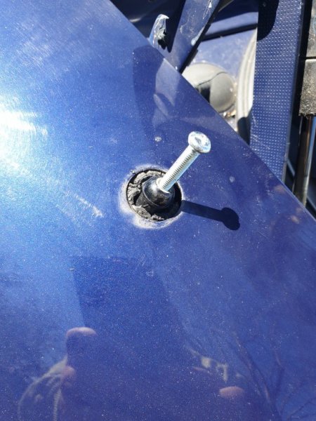

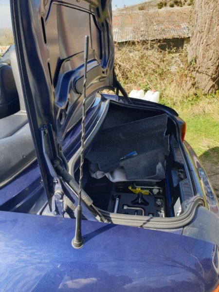

I did mine over the weekend. I used a bolt the same thread as the ariel screwed into the unit, warmed the grommet in hot water then applied a small quantity of washing up liquid. Slipoed the Grommet over the bolt head, pushed down whilst pulling up on the bolt head with a small pair of pliers and it went in very easily without even going into the boot. The trickiest part was carefully removing the badly degraded old grommet with needle nose pliers without damaging the paintwork.
