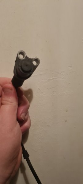

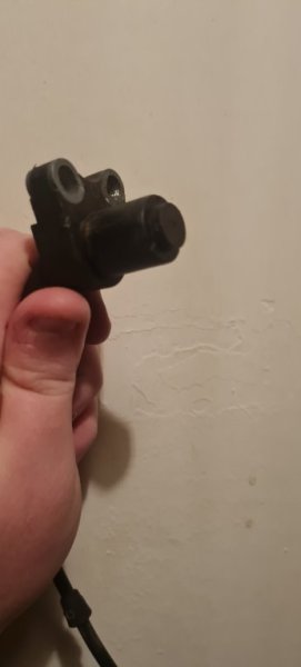

Hi everyone, I'm having an issue with my z3 2.0l m52 engine.
I'm getting a faulty rear left wheel speed sensor, I've replaced it twice but I can't remove the code, and the ABS/ASC light is stuck on my dash..
I've replaced the wheel speed sensor with a hella one I put in yesterday and I've driven the car a good few miles today but no luck
I also had a fault code saying the ASC button was faulty, I cleared the code and that ASC button code went away but not the wheel speed sensor code..
Thanks for any help given I really appreciate it

Unless it’s not the sensor but the ABS ring on the driveshaft, they can swell up, or distort, due to corrosion. Usually the left rear that’s goes first as it’s exposed to more crud/salt. Worth checking the face of the sensor, if you still have it, for any witness marks, they look like polished marks.

The connectors looked clean yesterday but I'll double check again tomorrow because it's dark out now
Thank you so much
Check that the reluctor ring on the driveshaft isn't snapped or even has a piece missing.
