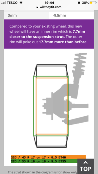

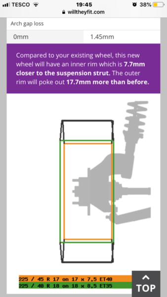

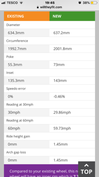

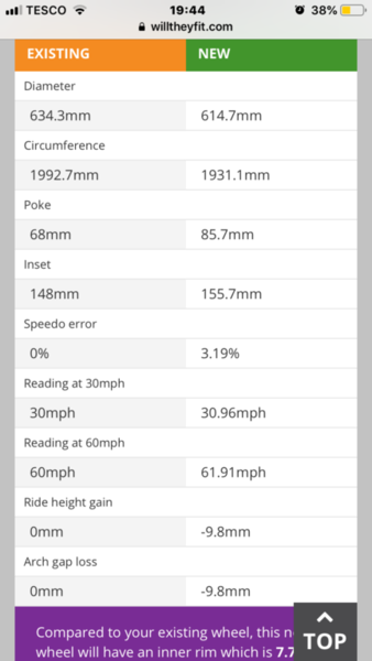

I kind of know what’s coming but I thought I’d ask, I am looking at some brock classic staggered alloys basically the numbers are in the images, my z is the narrow 1.9 140. Standard suspension atm. Is it a no no ?

So as follows current...
Front - 225/45/17 et40 7.5
Rear - 225/45/17 et40. 8.5
Brocks,
Front -225/40/18 et35 8.5
Rear- 245/35/18 et 9.5

Looking at the above post - the fronts are going to present a problem - for example I have 8.5 width alloys on my car all round with an ET of 43 and the wheels sit flush with the front fender - my estimate is that the brocks on front will poke out at least 8 mm beyond the front fender.
Unsure about back wheels - I need an approx. measure on your existing rear alloys from tyre edge to fender edge.

Whooo that’s a lot and I can imagine will look awful! I shall get the current oem wheel measurement to me it looks like 9.5 will not poke a lot at the back from the standard 8.5s but obviously the 5 difference in ET

I have 8.5 width ET 40 all around. fronts could come out about 3mm without sticking out. The rear can take 20mmspacers to the edge. I did 15mm so its just inside and matches my no spacer front..I agree with David, the front will stick out.
