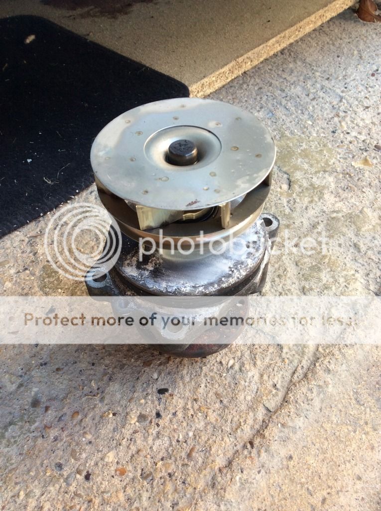

Removed waterpump, looks in good nick. Is the fan meant to have resistance whilst engine is off? - It has free play and can move it in both directions o_O

The fan should have some resistance it will move both ways though. When everything is cold it should be faily stiff if you push it round it should not move freely. If it is then it may be part of the issue.

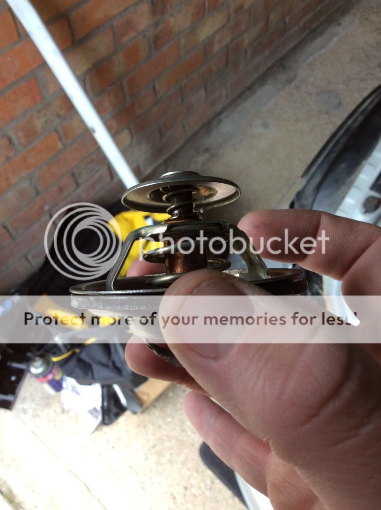

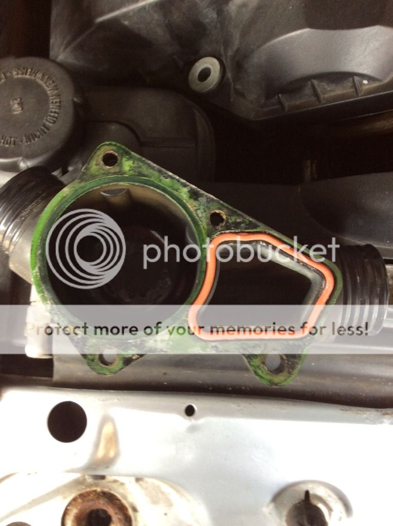

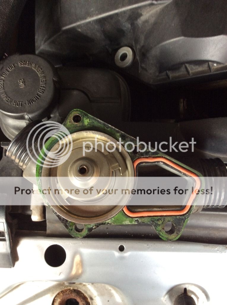

Took thermostat off, this is what I found-
Inlet bit to the thermostat is wet, outlet is bone dry
Ignore my chubby fingers, lol - top of thermostat is bent
You'll be needing a new one then mate. ;)

Yer, just seems a bit, well... easy - didn't think it would be a cheap thermostat
Would still need to take the head off mind :whistle:

If its not opening sounds like you found your culprit ..
Hopefully it is that simple that would be a result :thumbsup:
Got to worth a try with the new fan drive too. Fingers crossed mate:thumbsup:
