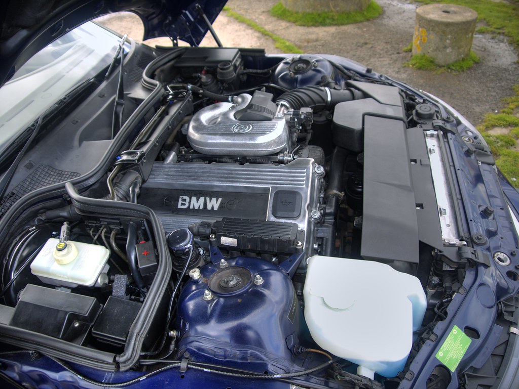

its just fitted to the radiator sort of slots in.... theres two screws to take out and it slides out....
dont think you can make it out on this pic....
keepers3 by handsomejackuk, on Flickr
Im going to have to have a closer look at the 2 of mine tomorrow now.
