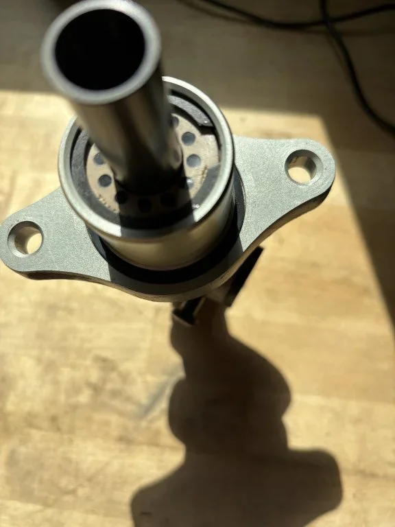

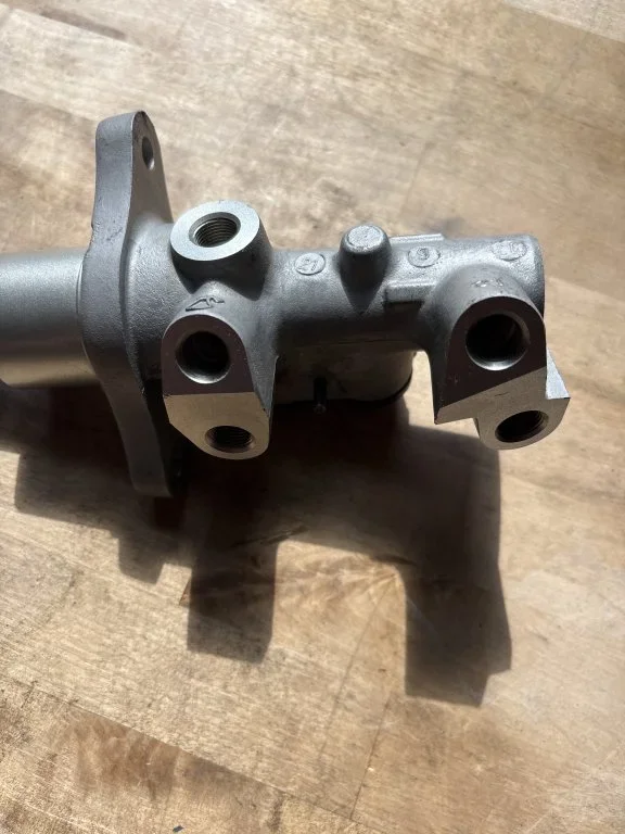

Thanks for your response. I appreciate it. The thing I’m finding is my DSC has the 5th port on the bottom side.( See pic attached). That’s the challenge as no one carries these. For a rebuild, the snap ring will need to be cut off or find a way to remove as it has no holes for a snap ring pliers (see pic).
