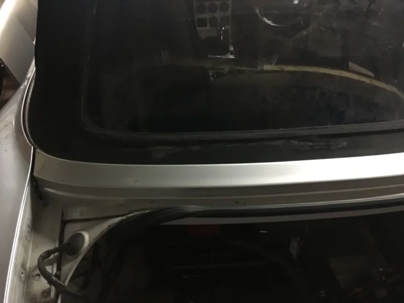

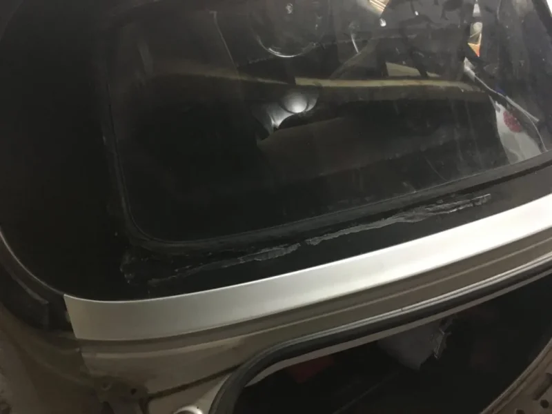

Is it glue or silicone sealant? There is a proper solvent for silicone sealant from DIY stores.
Also acetone has a good go at most stuff. Aka nail polish remover so you'll get a little pot for a £1 from Poundland etc?
Never tried either in quite this way though. So test on a small area etc.

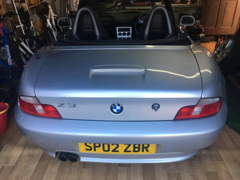

After changing the boot lid and getting locked out.
I had fitted the rear wings. New aerial grommet. Rear lights and put the boot all back together Inc another boot lid. All with new fixings from bmw.
I was pleased with myself.
Looking good:thumbsup:
