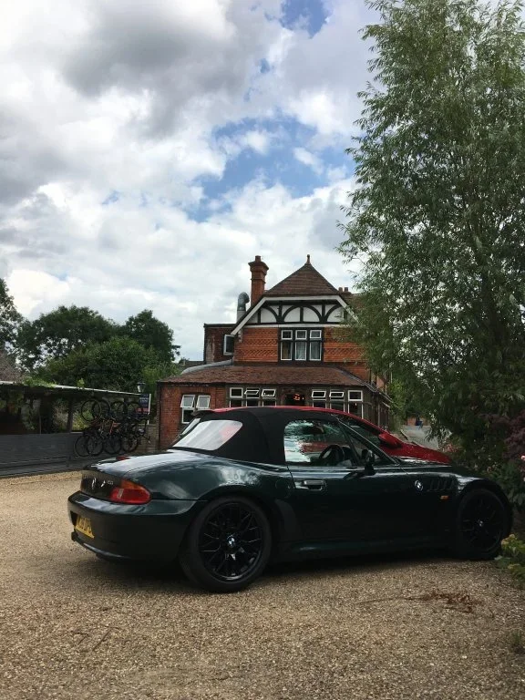

Well, thought I’d update this thread given it’s been over a year of happy motoring with the Z!
Too many of these, now that they’re cheap, end up filtering through a succession of owners who only hang onto them a few months before moving on!
I’ve been very busy on the car, but it’s at a point now where I’m really enjoying the ownership experience!
I also replaced the top mounts front and rear (Meyle fronts, Bimmertune urethane in the rear) at the same time, and replaced the front shock dust boots and bump stops with Monroe ones too (Koni’s didn’t come with any boots standard).
I also changed all the fluids (coolant, engine oil, gearbox and diff) for peace of mind.. not sure when they were done last, as I didn’t get any history with the car!
Next job is to replace the VANOS seals, as I’m sure mine are beyond their best. I’ve ordered all the parts, so hopefully they’re here in the coming days and I can let you all know how that goes.. happy to do a walkthrough guide if anyone feels there’s a need?

Dark wheels with the green body look fantastic.:thumbsup:
