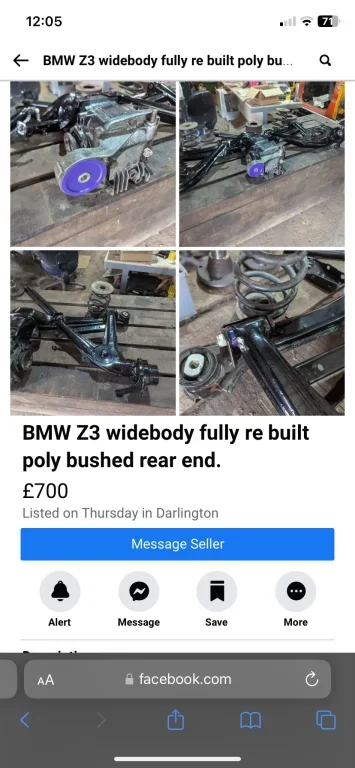

Saw this one today but I am not getting reply of what diff is that exactly.
Lee
Mar 26, 2014
213
Basingstoke
Z4 Coupe 3.0si
Ask if the internals have been rebuilt. Good price.

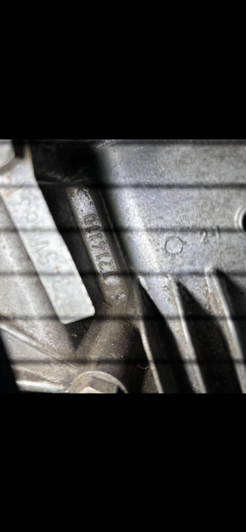

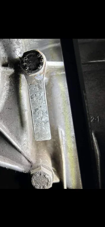

Apparently 2.0 subframe and “ wide body” diff but this could be pre face lift wide body 2.0 and not mine lsd from 2.8
Or know the reg of the car it came from.
Kai
May 12, 2024
49
Cambridgeshire
2.8 ROADSTER
If the 3.45 diff ratio on the tag is correct then this is an open differential from a 1.8 / 1.9 / 2.0, no LSD. If it was a LSD, it would have a 3.46 ratio.
Standard LSD for a manual 2.8 has 3.15 ratio.
This would make sense as the subframe is from 2.0 and mine diff is and 3.15 part number 33101428439 so it’s a different one. Which is a shame as would use a subframe with a refurbished diff for mine…
