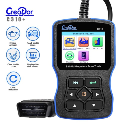

A code reader will save an awful lot of guessing and possibly expense. I've got an earlier version of one of these and it's pretty much essential, the adaptor leads aren't expensive, either. Not compared to what a garage will rook you, anyway.
colb
Nov 25, 2012
178
Newport, South Wales,UK
Good advice from the cat, code reader essential for all BMW's, the Creator 310 or 410 with a 20pin adapter will be a good buy. See if there are any codes and take it from there, could be a bad or dying camshaft sensor they do affect starting when they are failing. If you find a code for the camshaft sensor that would confirm its the issue. Replace with oem brand, no cheap brands always use Bosch or Siemens although I have had success using Hass brand sensors which are cheaper than oem brands. Also check all the rubber inlet boots and vacuum pipes across the engine for splits and holes that let unmetered air into the engine that has not been measured when passing through the Maf sensor.
