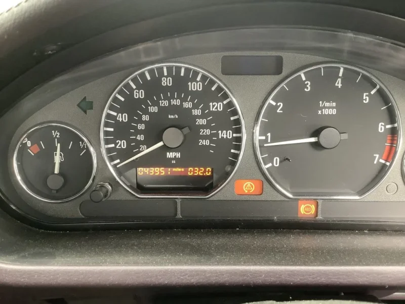

Hi, can anyone tell me what is the best ODB reader for a 1999 Z3 (2.8)
currently have the ABS and traction light on the dash.all wheel sensors are giving out a reading and no fuses blown so really need to pin point the issue.
what one’s work and also can reset the service lights if poss, many thanks.

So are you talking about brake pad wear sensors which there are 2, pads are only 1/4 worn and no wires off.if you are talking about the 4=abs wheels sensors then as I mentioned I have checked these.

With the lights on that you describe its likely that your problem is with the ABS pump having "dry joints" on the circuit board which need resoldering. A fairly common problem.
