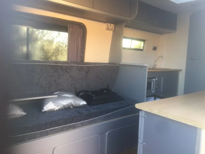

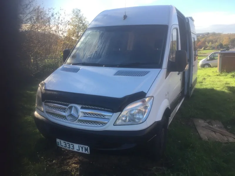

Hello zeders just thought I would update on how my project is coming on used the van over the summer had some great trips out not fully finished yet needs trimming up but useable added some pics for you to have a look at done everything myself including installing the windows

Fitted so far.
Full off grid using solar charging (320 watt but will increase next year to 630 watt second panel) of the batteries, also 20amp smart charger for use when on shore power, a 2000watt pure sine wave inverter, and using spit charging system from alternator used for over a week off grid in July with no problems with power.
240 volt shore hook up (when needed)
Dual Fuel Hot water heater gas & electric.
Pressurized water system

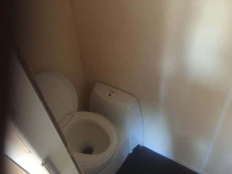

Electric flush Cassette Toilet

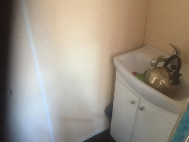

Shower (Wet-room)
Bathroom Basin
2 Bathroom extractor fans

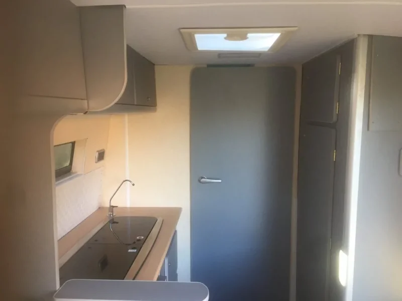

Air Conditioning

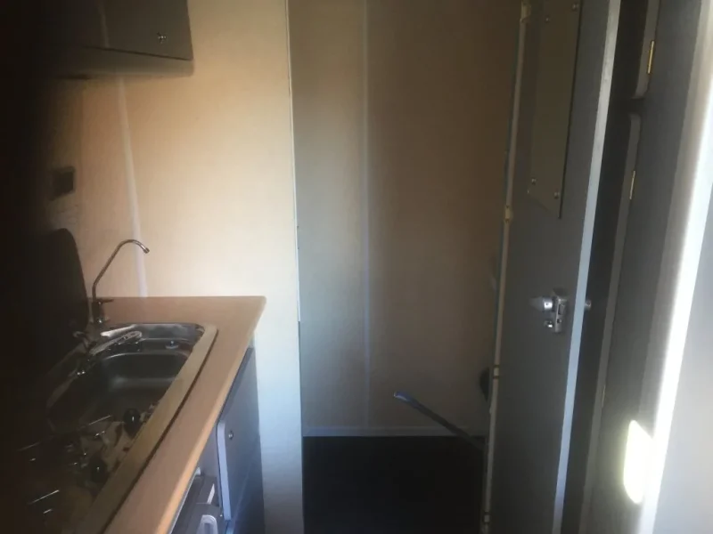

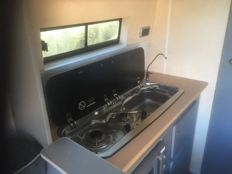

Combined Cooker & Sink
Electric Drinking water dispenser (5ltr spring water bottles or 25 ltr fresh water container when in the UK)
80ltr onboard water for washing and toilet outside fill.
Microwave
Dual Fuel Fridge Gas,12 volt,240volt

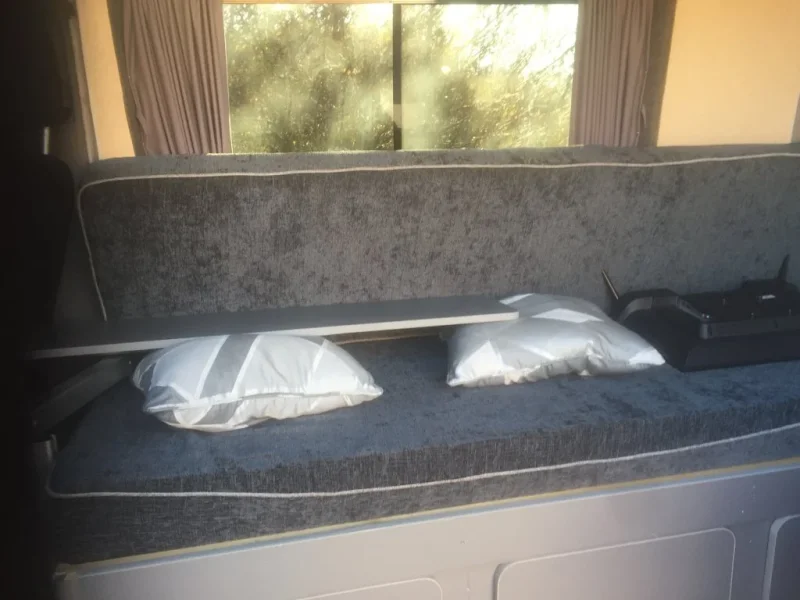

Pull out full size bed (really comfy)

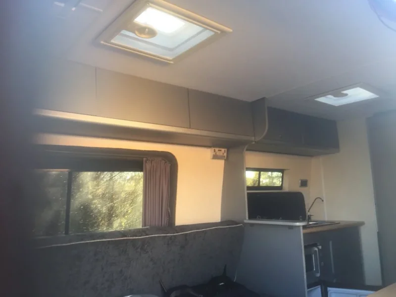

LED under cupboard lighting as well as overhead lighting
2 roof vents (one will be changed next year to a power extractor fan Maxxair Delux)
Electric 240 volt fitted fan room heater
Diesel room heater
Full internet connection (not failed to get signal yet)
Smart TV
Internal control panel controls heating lighting and everything else, battery state, heating & cooling thermostat.
Underslung gas cylinder re fuel from petrol station 62p ltr holds 25 ltrs and only charged it once so far. it still has 3 quarters left
Cant forget the important stuff, Gas detector, and carbon dioxide detector, linked with full CCTV motion detection that can be accessed anywhere from my phone informs me of any issues I can also activate the alarm on the van if required.

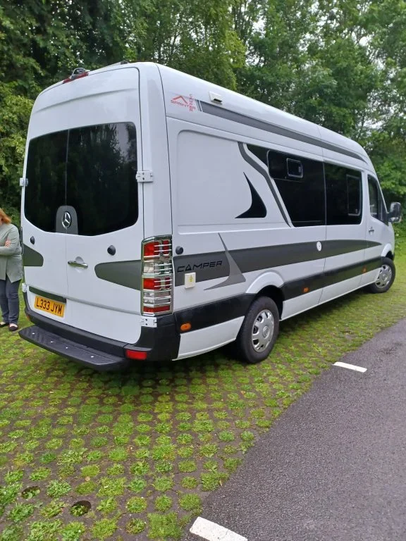

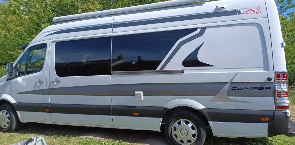

Van very nearly done now,been a lot harder than owning a Zed, but it has its benefits, re spray and graphics now completed, have used it a lot this year,just got back from a 3 day trip to Tenby, weather was scorching was glad I fitted air con in it, ready for a major euro trip next year

That looks fantastic mate, you should be very proud of it.
