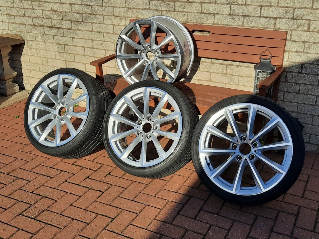

My old 19" waiting for a new home.
They would be good on a Z3M …..
Mmmmm??? Next project?? :whistle: :whistle: =))=))=))
