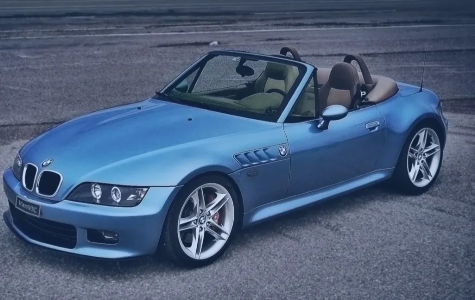

This belongs to a friend. He is the one who actually had me looking for a Z. Personally I consider this as the most modified Z ever.
Sharing for your comments and viewing pleasure. He does not do “internet” so if you have any questions, I can ask and report back.
What a beast of a Z this is…

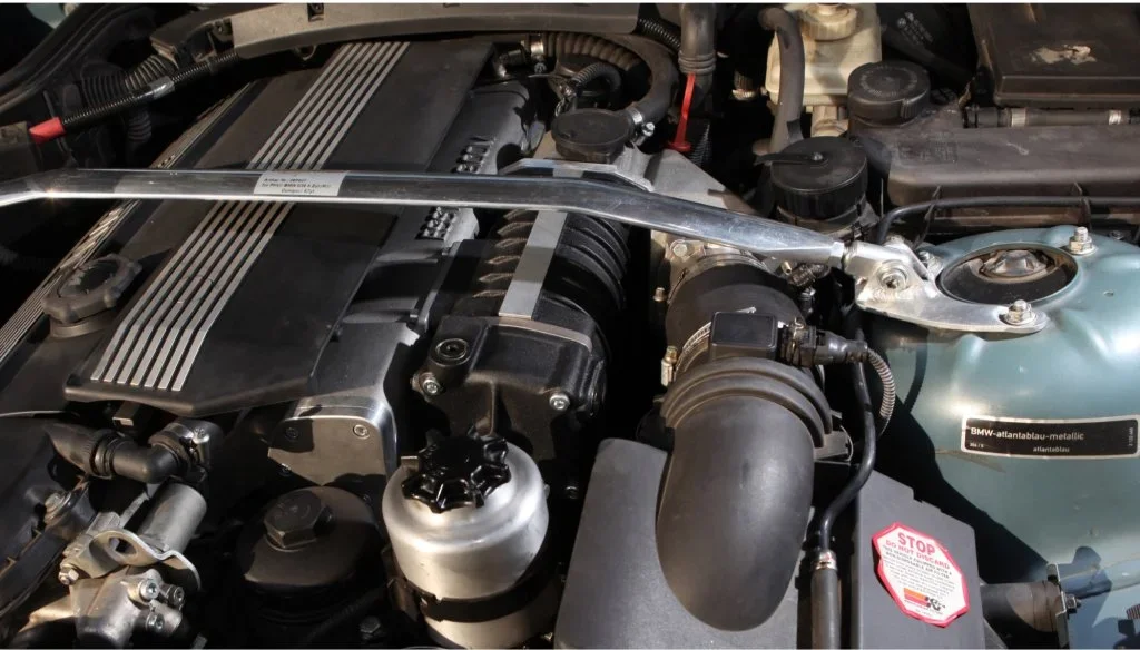

  • F/I aspiration: ESS TS2 series supercharger system (Lysholm Twin Screw) upgraded to TS2++
  • ESS optimized, dyno tweaked MS43/MS45 ECU software, locally fine-tuned for 8,75 psi set-up
  • High strength, dual-layer cast aluminum alloy ESS intake manifold with integrated high capacity Laminova based liquid intercooling system
  • Cast aluminum SC intake system with crankcase fume reduction system designed for boost
  • 264/248 camshafts by SCHRICK
  • ESS TS3 spec fuel injectors by BOSCH
  • Heavy-Duty drive belt
  • Performance underdrive pulleys by Rogue Engineering
  • Electronic speed limiter removed -RPM limiter @ 7000 rpm
  • High-flow air-filter by K&N
  • High-flow throttle body by DINAN
  • Limited-slip "M" differential (3.15 ratio)
  • Lightweight organic clutch
  • Custom short-shift gear box
  • Heavy-duty transmission mounts by Rogue Engineering
  • CDV replacement with non-delay valve
  • Front: aluminum strut brace by WIECHERS
  • Front: full-metal ball joints by MEYLE
  • Front: anti-roll bar's POWERFLEX bushes
  • Rear: carbon fiber strut brace
  • Rear: custom sub-frame chassis reinforcement kit
  • Stainless steel manifold by SUPERSPRINT
  • Inox front/mid pipes kit & rear silencer by SUPERSPRINT
  • Catalytic converters HJS 200 cpsi by SUPERSPRINT
  • Front: AP Racing-Galfer 6-spot calliper with 330x30 drilled disks
  • Rear: Z3M brakes kit with 312x20 double vented disks -custom discs mounting bell (hard anodized alum.) with bleed screws
  • Brake pads DS2500 by FERRODO
  • Steel braided brake hoses with nylon armor protection
  • Competition brake fluid DOT 5.1 by AP Racing
  • MadMAX coilover by MAD Sportive
  • Hartge rear anti-roll bar 22mm

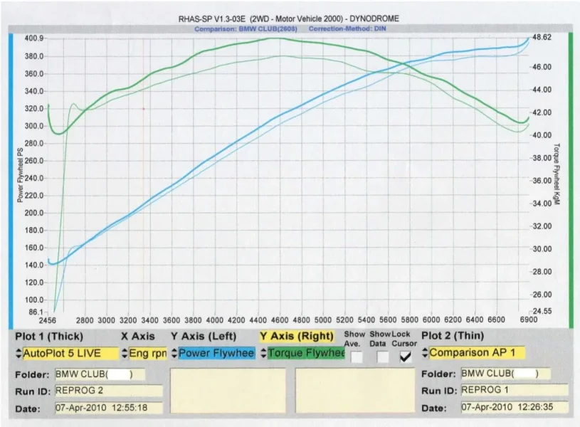

  • Power output: 300 KW @ 6900 RPM
  • Torque: 48 KgM @ 4500 RPM
  • Top Speed: 260 Km/h (RPM limited)
  • Acceleration 0-100 Km/h: 5 sec
  • Acceleration 0-1000 m: 24 sec
  • Acceleration 0-400m (1/4 mile): 13 sec
