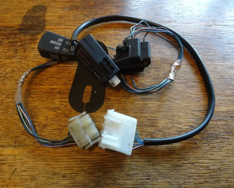

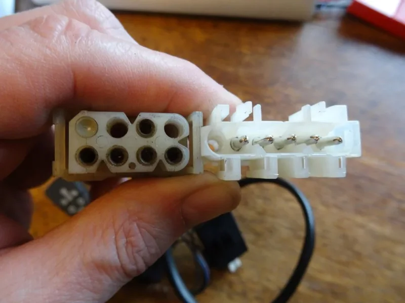

Hello chaps,
So I thought I would give the retro cruise control refit a go. I got the instructions off this site. I bought all the bits and, unfortunately, I appear to have a compatibility issue. Please see the pictures. The wiring for the cruise stalk won't connect to the cruise adaptor. Do I need a different adaptor or a different stalk? Thanks for your help guys.

You likely need a different stalk switch.
There are 2 different plugs on what looks like the same stalk:
  • Z3 Facelift, Electronic control via CAN-bus to the DME, what you want
  • Z3 Pre-Facelift, Electromechanical control direct to the throttle body, what you have
The switches have very slightly different internal electrical connections. People have been able to splice the pre-facelift switch onto the facelift module. You'll need both sets of wiring diagrams and he ability to read and understand them.
Probably easier to get the correct stalk switch.
