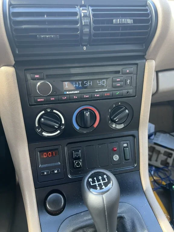

Thanks guys. I ended up fitting the Blaupunkt Milano 200BT. The alignment post in the back it did not come with but I was able to remove it from my OEM head unit. It was a tight fit, but I was also using a wiring adapter rather than splicing wires. What ended up working for me was I got a bit of string, looped it around the wiring harness and through the OBD2 access port in the passenger foot well and used that to pull the wires down and out of the way so I could push the head unit in. Not an easy fit but it was eventually possible. Very happy with the install and keeps a somewhat factory look.
