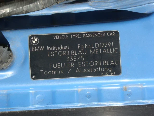

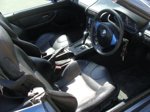

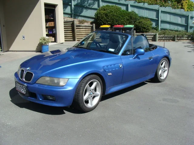

.....Surprise, its another Z3. That makes 3 in the Zed Shed. This one is a doer upper and sell, so should not be around for long. Currently it is a bladder shaker at 100 km/hr, so lots to do.
Yet it is an Estoril Individual Model with sports seats, side impact air bags, M sport suspension (means its lower and inch or two) and sitting on 17" rims. The 1.9 L with Auto is very zippy around town, so it may take me a long time to get it all sorted.
Already have a list of 27 repairs to do, from fitting a new rear window and new tie rods to cleaning everything. Its filthy. The biggest dilemma is how do you take off the wheels when there are BMW security lug bolts and no adapter tool? Have purchased all sorts of sockets and trox tools today to hammer into the splines in prep for when I have new lug bolts in hand. Anyone have a better suggestion?
Over all, very pleased with the purchase, got it cheap and the parts list ordered today have not amounted to much yet. Most of it from international suppliers, so it will take a while for it all to turn up. In the mean time I have lots to do on it.
