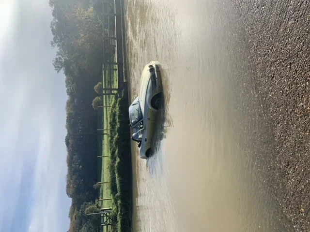

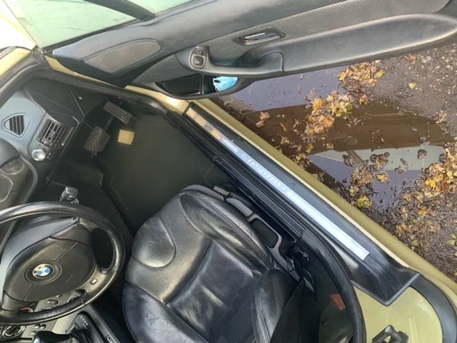

I managed to get stuck in floodwater yesterday in my Z3 3.0l, water came into the footwell and the boot. Engine also cut-out which suggests it got in the engine. Im assuming this will be write off, any experience of this issue and also the insurance company if you had a write off situation with a car that may be worth more than book. Thanks for any insight

The air filter was soaked and water was sitting at the bottom of the bit you insert it in. The bottom parts of the seats are still in a 4-5" pool of water and the battery is in water as well. The other concerning thing water seemed to be behind the radio which may have just been condensation. The main issue or cost risk is the engine which would be the biggest cost item to replace as im not a mechanic

Total miscalculation going through a Ford I’ve been through many times before
Sorry to be so blunt - you can tell when water is unusually high on roads - shouldn’t take chances like that - particularly in a low set car!🙈

Having a quick google about saving a flood damaged engine in fresh water is to remove the plugs and turn over by hand to expell water out of the cylinders then drain oil and replace with the filter and empty petrol tank if water got in and try and start. If it does recheck the oil and if water present redrain oil and change filter again, rinse and repeat. Personally if you really want to keep the car I would try the first step and if it runs ok have the engine out striped down cleaned, may as well change the oil pump, tensioners and chain while in there a rehone and set of rings, main bearings and shells. I suppose it’s going to come down to how much electrical there is to modules but I suppose you could strip out the dash and modules and place in the airing cupboard for a week and get some dehumidifiers and heaters in the car after stripping the interior out and see if you can get it thoroughly dried out.
