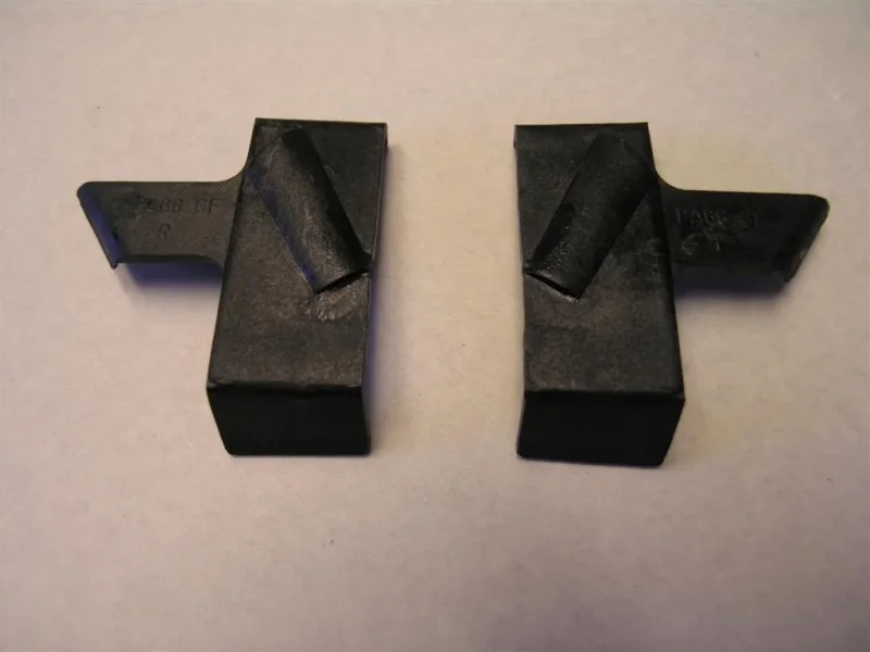

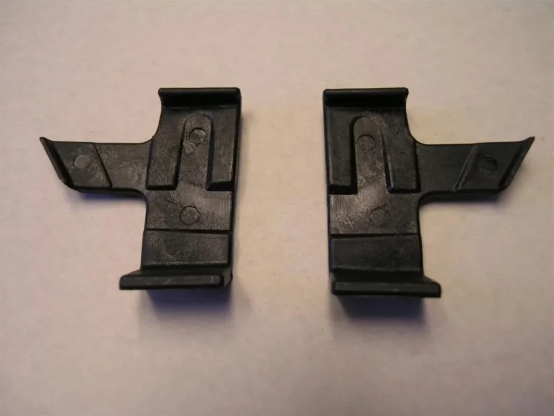

I've got a spare harness to connect the heated screen if you want it (message me and I'll chuck it in the post) and I would be incredibly interested in borrowing the little plastic spacers for aligning the top if you have actually managed to source those (I might have a go at creating a 3D printed version as well if I get my hands on some)
Cheers
Iain
the thickness of the gauge not including the leg that apparently rests on the body panel is 6mm and including the leg is 12mm.
