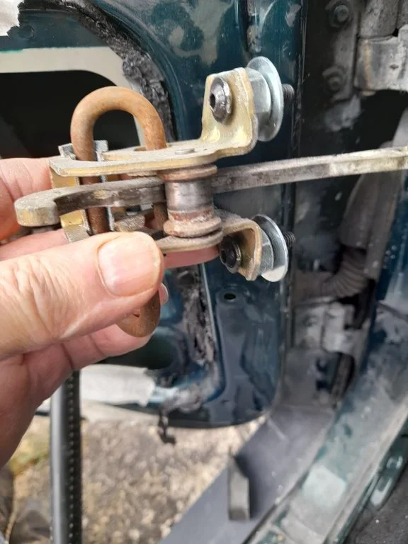

    Duncodin replied to the thread Door hinge loose.
    This is what it looks like. Ignore the screws and shiny nuts and washers in my picture - yours won't have them there - I've modified my...

  • Duncodin
    At the front on the pillar by that rubber grommet there's a pin that can be removed - circlip underneath. That disconnects it from the...

    Pond replied to the thread Door hinge loose.
    The door won't fall off as long at both hinges are secure. As said, the part in your video is just to stop the door from opening too far...

  • colb
    colb replied to the thread Door hinge loose.
    Two bolts door side of check strap and the pin on the a pillar will get it out to see what's worn or broken, if it needs replacement ask...

  • N
    Nuieve replied to the thread Door hinge loose.
    Is it somewhere deep inside the body panel and hard to access and replace? Does it need to be fixed? I don't mind it cracking as long...
