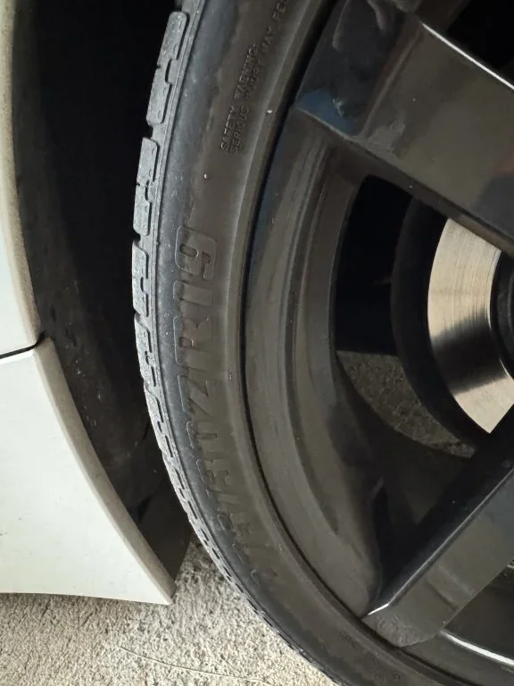

I have rear tyres 275/30 R19, one of them has a puncture. Does anyone know where I can get a replacements in QLD Australia for less then $600 for a run flat?
Also, just toot of interest how fast can you go on run flats? I went at like 15 km per hour and it felt unsafe….

275/30 in run flat was never fitted to an E89…
What width rims are they sitting on?
Stock tyres should run upto 80 kmph with some degree of ‘wobble’ ok

Yeah, these are super big and were on the car when I bought it.
look awesome but I wonder if they make the car too jittery, esp in the wet.
