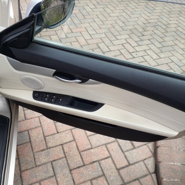

Having issues with electric windows, all windows except rear RH (drivers side) go down when operating the roof switch, rear RH window remains stuck, all windows do not operate on the master switch, the passenger window switch is working, any idea what is going on?

The drivers side master switch does not operate any of the windows, the single switch on the passenger door does operate that window.

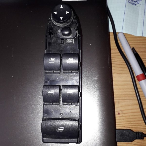

You could be right, all windows except the drivers rear go down when operating the roof, the passenger door window goes down using the passenger door switch, non of the windows operate on the drivers door master switch, had my mate diagnostics plugged in and all windows go down and up except the drivers rear, so i am thinking it a window motor fail, and the master switch has gone also, awaiting BMW to give me the correct part number for the Master switch, as it does not have folding mirrors, all switches on the web have the additional button for the mirrors.
Yep, mine is also like that. Have you had a look on Real.OEM.com for part numbers?

New switch arrived but now I think it's the window motor anybody know how to get access to it please
