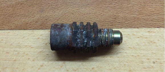

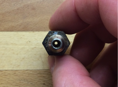

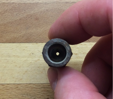

Anyone done this mod? Any info appreciated. Car can be a little jerky when taking off if you don't take your time, and takes a while to really bite on the clutch during rapid gear changes just for a spit second, Are these all CDV related issues?
Gonna do it ASAP Gary, but a few different opinions are about, do I remove it completely http://www.diymybmw.com/e46/clutch-delay-valve-cdv-delete/ or Mod the one on it and replace it????It's exactly the same reasoning behind doing it on the Z3 Jim, get on with it! I would personally take any potential negatives over the smoother gear change. Need to sort it on my Z3, just haven't had the time or cash to do it yet. Didn't need it on my Z4 cos that was an auto...
Good point Gary, don't suppose anyone knows the part number for the Earls Braided Clutch Hose?I would personally go with the Earls braided clutch hose option. Better all round. Although if you want the stealth look you could modify the existing one I guess.
