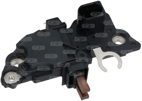

I have ordered a new voltage regulator.
The reason I wondered at first whether it would cure the problem was because I thought it would just be a collection of resistors and other electronic components.
But I now see that it is more the fact that it contains a new set of brushes..

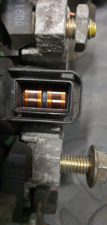

However, thinking it might be stuck brushes, I gave the alternator a few light taps with a mallet, worth a try, but no difference.
So I decided I would take the regulator off. Loads of room after removing the airbox.
I then took of the main red cable (battery has been disconnected)
I then unscrewed the black plastic cap on the engine block side to get to that stud and nut. I undid a small Phillips screw at the bottom that holds on the plastic, and tried to remove it, but it was not budging. I wondered if it was still held on by the nuts on the posts.
I then set about taking the nut off the main terminal post, it was very tight and I was wondering if this was correct.
After a large amount of force it turned, but it then appeared that the post was loose, Oh s*** I have snapped it off inside, I thought.
So off came the whole alternator. a job I was trying to avoid.
When I got the alternator off I saw the plastic cover was indeed held on by the nut on the main terminal, and another nut on the terminal post to the right hand side.
Both nuts removed and the cover came off.
This time both posts came loose, but they are captivated, so it was normal, and the alternator didn't need to be removed after all.
Anyway got the VR off and there appears to be plenty of life left in the bushes, and there was also plenty of spring force pressing them against the commutator.
Now I hope it's the electrical components after all.

So, heres the update.
The new voltage regulator arrived.
Whilst it was off, I checked for a circuit between the left hand pin in the socket and the horseshoe terminal.
On the new one it was 4.5 m ohms
On the old one, open circuit, so there's an encouraging difference.
Also there was resistance between the l/h pin and the brushes on the new one, but open circuit on the old one.
Refitted it and started the car,
Output is now 14.5 volts, not 11.4v, hence now charging the battery.
Yay!:party:
Then plugged in INPA and cleared numerous low voltage errors, which did not return.. :thumbsup:
Great result for £29.
