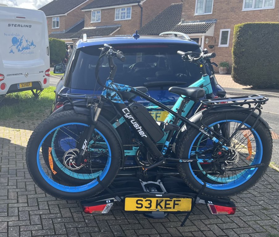

The Thule Easyfold XT that carries our 2 e-bikes on the tug, which is the requirement for a tow bar on the Z3, as below

I don't think that will be safe for the Z3, that will be way too much weight for the rear bar.
If you look in the manual it actually says you cannot fit a tow bar to the Z3 but some companies made them anyway.
When you next pop down to the unit I'll show you closely why its an issue on the Z3, theres a 2.8 fitted with one there.

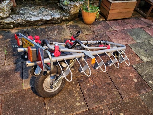

Perhaps if the tow bar is doable, I'll figure a trailer to tow the e-bikes behind the Z3.

You could easily make a bike carrying trailer under.the towing weight limit. I made a boat trailer for a friend back.in the day.
Another friend went to work in the Greek Islands after his wife died, he wanted to take a Honda 50 along so I built a carrier for that which bolted onto the towbar on his Mk.3 Escort. All it takes is a little enginuity and imagination.

I could modify my small erde trailer, but need the tow bar 1st
