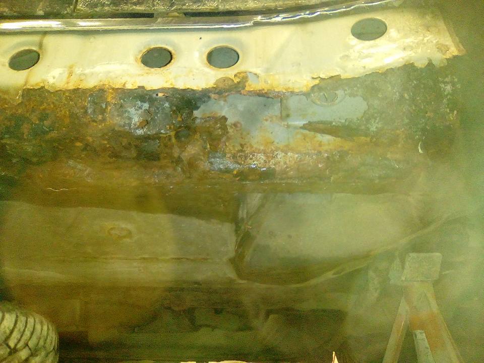

That sill is tossed and really needs replacing, you could fill and paint it but it won't last 5 minutes, it would be well advised to remove it and take a good look at whats on the innner sill, this is the part that is structural, for some reason some rot a lot and others barely rust at all, this is one that I have just sorted
during
done

But these things normally rot from the inside out. So Sean is also right to warn you about getting the cover off to check - easy enough btw.
It could be hiding something nasty on the structural sill underneath. Fortunately most rust found on the inner sill is surface rust and can be treated. Preferably with Por-15 or similar. Sean was unlucky to discover what he did.

As others have said the sill cover needs to come off and the inner sill, which is structural, needs checking and repairing if needed.
Normally, corrosion is in the areas subject to stone chips, particularly the sill ends where they are in the wheel arch. The rust you show is not a stone chip area and may be due to some damage and repair earlier in the cars life. All the more reason to check the condition of the inner sill.
I replaced both of my outer sills and front wings last year for under £500. I fiited them myself but painting was done by a bodyshop to my specification. The £700 for one sill is way over the top, total labour should be no more than 4hrs, although there will be more time than that waiting for paint to dry.
The underside of the outer sill panel, including the return flanges in the wheel arch, should be protected with a stone chip protection paint (PVC or PU) before it is painted with primer, basecoat and clearcoat. I also painted the inside face with waxoyl before it was refitted.
For the inner sill; remove the jack pads and take off all of the loose rust. If the sill is perforated it will need welding, but on most it is just surface rust. Treat the rust with your preferred product (POR15 is favoured by many on the forum). I also sprayed inside the inner sill with a protective wax. There are a couple of drain holes (embossed areas) where the sill is fixed to the underfloor. Use the end of a cable tie or similar non metallic poker to ensure they are clear. I also replaced all if the fixing bolts, which is not really necessary.

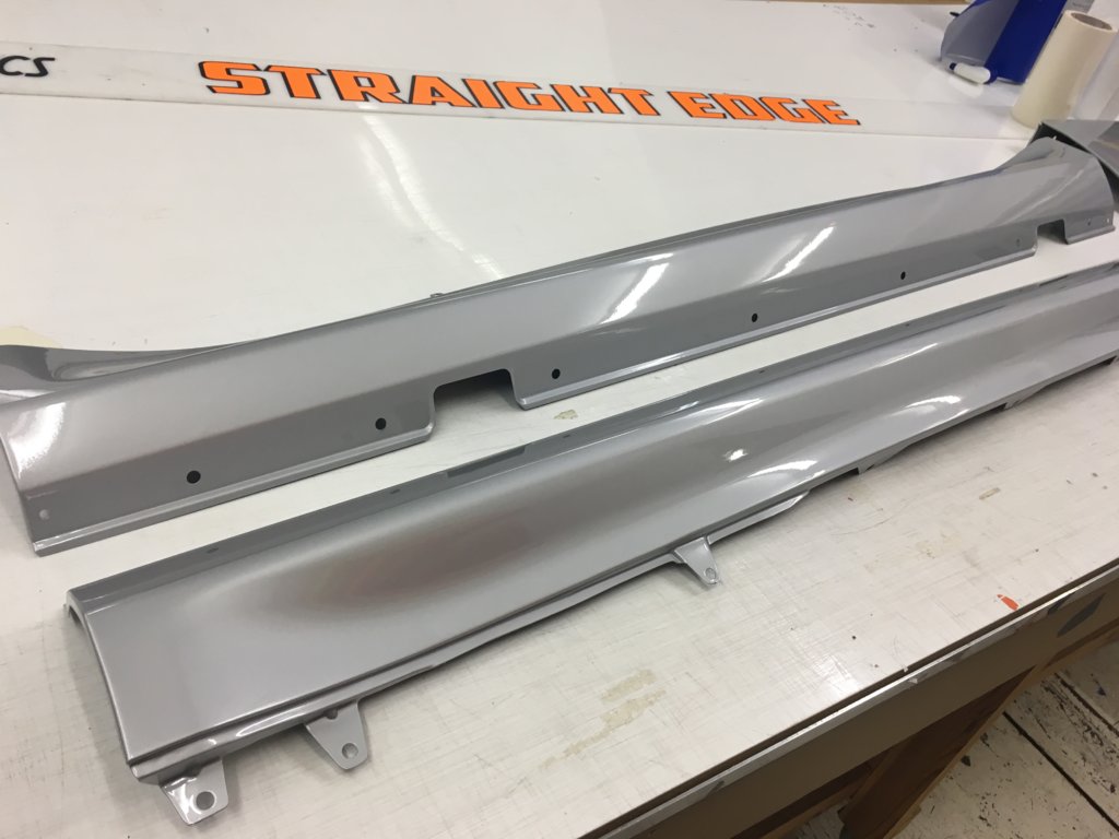

For painting, opinions will certainly differ. Best for colour match is to paint on the body, however, as yours is black and non- metallic any good bodyshop should be able to get a good enough match spraying off the body. For applying rust protection off body painting makes it easier. The final paint finish is better heat cured (typically up to 80 deg C) and if you have carefully applied wax etc. to the inner it could well be affected. So for painting on the body you will need to make sure you carefully choose the protection products you use.

Definitely have it sprayed off the car. They will get a good colour match off the old one unless they are complete numpties.
It doesn't need to be blended with adjacent panels - that would be a massive job. The paint job will be much neater on the edges of the sill cover and it will avoid a load of masking up and risk of over spray on the car body. Plus you haven't got to leave the car there.
