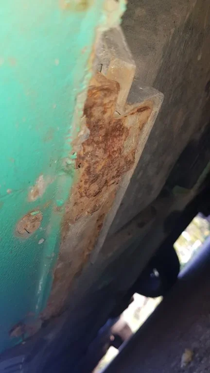

New member @Matt Barnes is looking for helpful info re replacing out sill covers and treating corrosion on the inner sills please. Any and all information on products to remove the corrosion will be appreciated.
cheers Tony!!....New member @Matt Barnes is looking for helpful info re replacing out sill covers and treating corrosion on the inner sills please. Any and all information on products to remove the corrosion will be appreciated.
These are my inner sills by the waycheers Tony!!....
Yep, I'll happily sing the praises of Deox gel (no affiliation etc)View attachment 149969
Deox crystals are great. This was only a light coating of surface rust from inactivity but was completely cleared overnight. The sill cover ends can be dipped into a bucket of the stuff - that’s where they are usually worst.
@DrWong can tell you about the Deox gel for inner seals. Not so keen on that personally.
that's an amazing round up..thank you so much..your original pic looks identical to mine!... there is hope !Yep, I'll happily sing the praises of Deox gel (no affiliation etc)![]()
If you want to get rid of the rust - as opposed to covering/converting it - I can't think of anything better. It dissolves just the bad stuff and leaves good metal behind. Great for deeply pitted areas like inner sill ends.
Takes bloody ages though, but worth it. See my previous thread if interested: https://zroadster.org/threads/chassis-sill-refresh-or-lessons-in-optimism-bias.26071/.
I took the inner sills back to bare metal with Deox gel, then painted with epoxy primer and then colour-coded top coat from rattle cans. It's holding up fine and the rust hasn't returned. Outers sills are shot though hahah

hmm interesting, mine looks pretty deep but I'm hoping it's rotten underseal, I won't know until I grind it back...thanks !Interesting video. But you’ll be likely if your corrosion is that light.
Por-15 gets mixed reviews. Funnily enough I went back to look at a car I did with it 3 years ago this week. From what I could see the rust was creeping back through.
