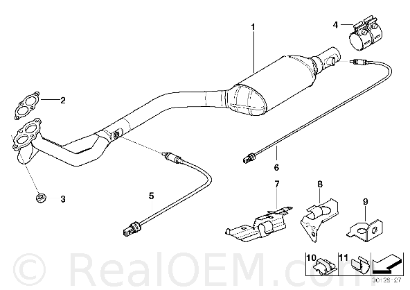

Just had a look under the car and can only find 1x oxygen sensor (in the front pipe before the cat) but
all the drawings ive seen mention 2x , one before and one after the cat .................??????????
Was this normal on the 1998 1.9 car?
Helpppppppppppppp. :-s

I'm not sure if you have heard of RealOEM.com or not, but it allows you to find all the parts for your BMW. You can also use it to break down the parts for your particular car.
If you enter your car details or last 7 digits of your VIN number, then look for the Exhaust System from the list you should be able to locate the sensors from that.
http://realoem.com/bmw/select.do

If my Realoem skills are correct, this should show you both 1.9 engine exhaust systems.
1998 1.9 M43 engine Parts 5 & 6
1998 1.9 M44 engine Parts 8 & 9

Well guys my exhaust has only 1x oxygen sensor before the cat,if you take a look at the drawing it shows 2x,i downloaded
the data and registered it against my VIN number,on doing this i could only obtain the part number for the front sensor and
no number was available for the rear,guess all is correct with my car having only 1x sensor otherwise 2x part numbers should have
been seen (the rear sensor would have a longer cable thus different part number)
Any way, i crawled under the car last night and disscontected the sensor plug and cleaned the connections,this morning when i started
the car it fired up perfectly and idled correctly.............................................................ive changed the sensor for a Bosch
part just in case it was a fluke..............................will report back if it has cured the problem 100%. Fringers crossed..... ;)
