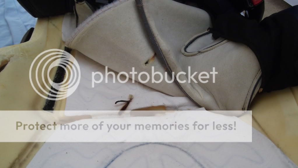

    As part of @BMBabe's Project Panther we have an interesting issue with the heated seats - primarily the drivers.
    It gets almost hot enough to burn skin, so we are figuring something isn't exactly right. It has the same style sport seats as I have in mine, and those don't get anywhere near that hot - just nice and comfy.
    Not really sure where to start looking on this. I'm assuming there must be an obvious place to start looking on this issue.

    I would not know Gaz as I do not have heated seats.
    This any help?
    upload_2014-11-10_22-12-10.jpeg upload_2014-11-10_22-9-15.jpeg upload_2014-11-10_22-9-45.jpeg upload_2014-11-10_22-10-11.jpeg upload_2014-11-10_22-10-38.jpeg upload_2014-11-10_22-11-2.jpeg upload_2014-11-10_22-11-24.jpeg upload_2014-11-10_22-11-47.jpeg upload_2014-11-10_22-12-10.jpeg upload_2014-11-10_22-12-28.jpeg

    On which setting does it get too hot '1' or '2'?
    Depending in what you wearing 2 can feel very hot but it switches down to 1 after a set period of time....but being a Z owner and occasional forum browser you probably know that already...!!
    Just a thought: Have the seats been recovered- perhaps the the foam lining on the underside of the leather is not the there or different leather used (not sure if it would make much difference though).

    A couple of things you could try:-
    • To rule out a switch issue swap the switches over, if the drivers seat still gets too hot then you know it's a seat issue, if the passenger seat suddenly gets too hot it is a switch issue.
    • If it turns out to be a seat issue, measure the resistance of the heater elements and compare side to side.
    Did I mention that you may have an issue ;)

    On the drive home after collecting @BMBabe's car i put both heated seats on. @pgunter was passenger and to his amusement he saw me start jumping around after a few minutes because it was burning my "Ass"
    Test one - (thanks to @Brian H) I will swap both switchs
    Test two - check the eliments resistance (Fluke Meter in my garage)
    Test three - Get @GazHyde to sit on the seat for each test
