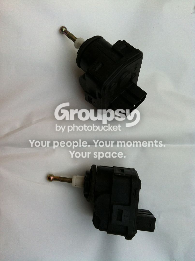

Just as an aside here Andy, some people don't know but you can make a manual adjustment by screwing the adjuster peg in/out before fitting the adjuster into the rear of the light as the electric motor only has a limited amount of travel. That's just in case anyone buys one and says it won't move far enough!
