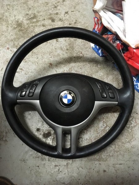

I’ve fitted that wheel to mine, according to the brochure in 1999 that’s what should of been fitted but the dealer rang me to say it wouldn’t have it due to technical issues. They did finally fit them around 2001, it may look like an E46 wheel but hub/slip ring is different.
Yes the airbag has to come out then you will see fixing screws for the upper and lower trims then two behind the lower spokes. I found the hardest part is getting the round airbag out but once you’ve done it a few times it gets easier.
Here’s mine Royal trimmed with extra padding, standard leather and silver trim.
