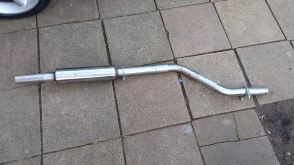

When my front silencer fell to bits inside, and the rear had rust spots all over it, I had a stainless cat-back system made by MTJ exhausts of Walsall, designed to give equivalent noise levels to an E36 saloon. It mad a big change not to finish a long run with ringing ears!

When my front silencer fell to bits inside, and the rear had rust spots all over it, I had a stainless cat-back system made by MTJ exhausts of Walsall, designed to give equivalent noise levels to an E36 saloon. It mad a big change not to finish a long run with ringing ears!View attachment 337941
Hi Mike, thanks for thd info.....I have found a company y in Leeds who can build one for me at what seems a reasonable price but they mention re mapping which I don't really understand....did you have to have yours re mapped?

I have never heard of a car needing to be remapped after a change of exhaust system! It sounds like a means of richening the mixture to stop popping back due an air leak, rather than findng the cause - curing the symptom rather than the cause!.
Even when my car had a stainless Eisenmann rear silencer it did not give any problems - apart from being too noisey.

I ordered the Sport version, which promised OEM noise levels, but between ordering and despatch they decided to standardise on a compromise level. It sounded great for a short time in tunnels etc, but a long day's motorway run left my ears ringing. After many years of large diesel engine noise I decided that my hearing had been sufficiently damaged, and went for a custom quieter syatem, which has been fine.
