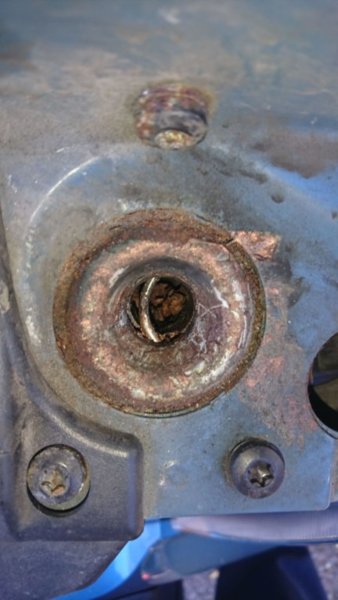

Take a look inside the holes that the bonnet pins go into, there should be a stiff bar going across one side that grabs the pins when you shut the bonnet, my guess would be that you have bent one or both forcing the bonnet open
James S
Apr 26, 2018
20
North West London
Z3 2.2i
@Sean d - I think you're right. Both locks looked a bit like this:
Using a pair of needle nose pliers I've bent the bars back like this:
