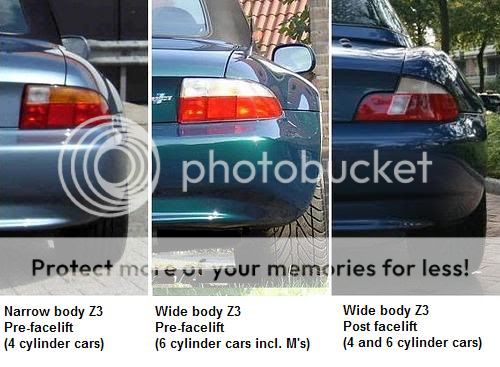

    Z3M's weren't "face-lifted"
    There were three engine versions depending in where you are in the world. Europe started off with the S50, and then changed to the S54. North America had the S52 (250ish BHP for a while and then changed to the S54.

    Above......^
    [​IMG]
