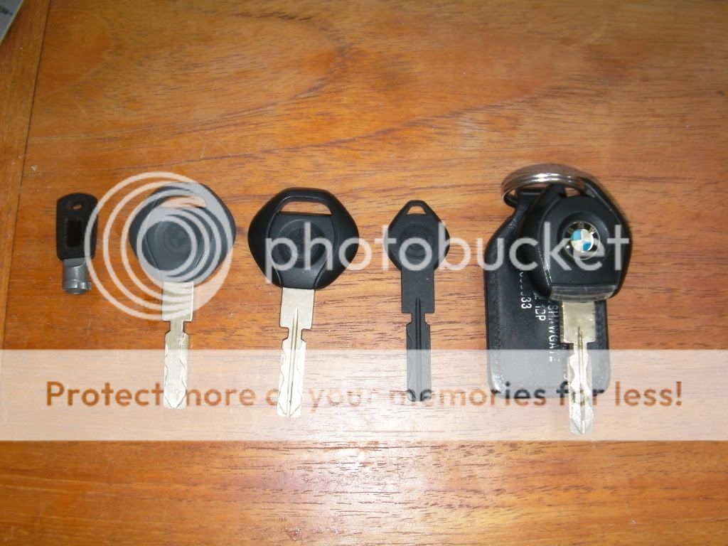

Depends which alarm system you have, they were all after market systems added to the car once they arrived at the dealers if I remember rightly.
I had this type, key on far left (Not my photo)
