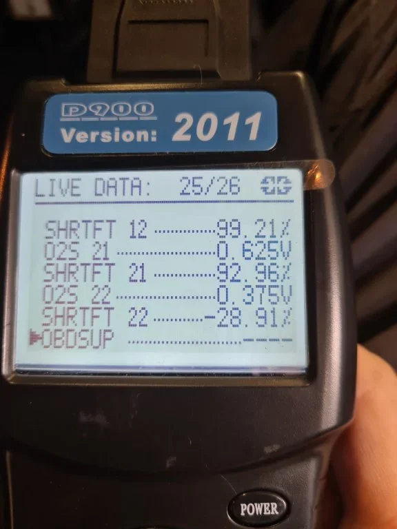

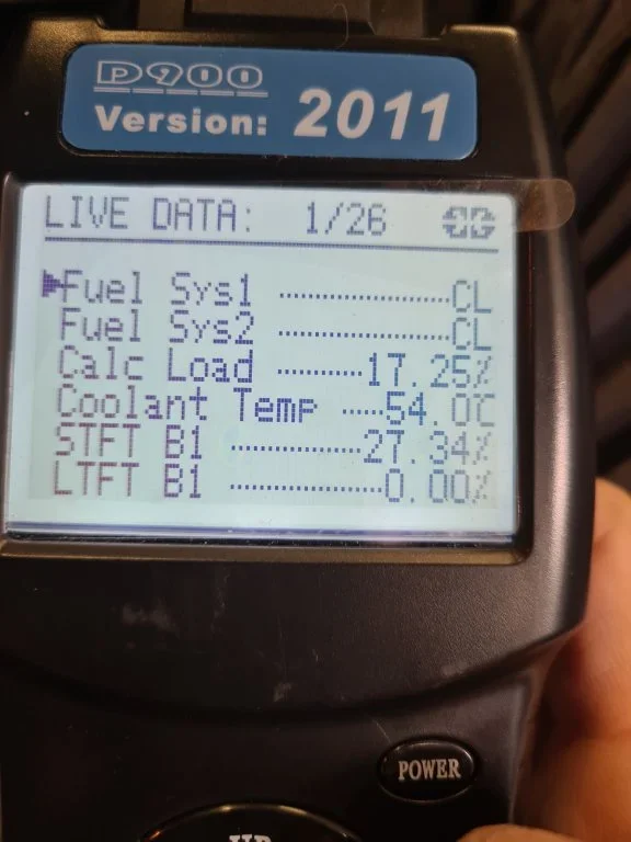

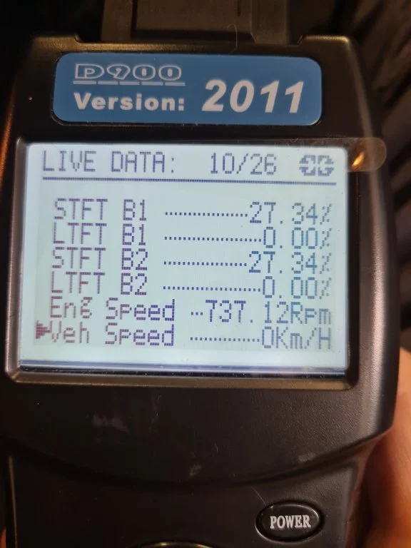

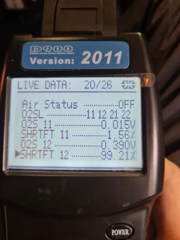

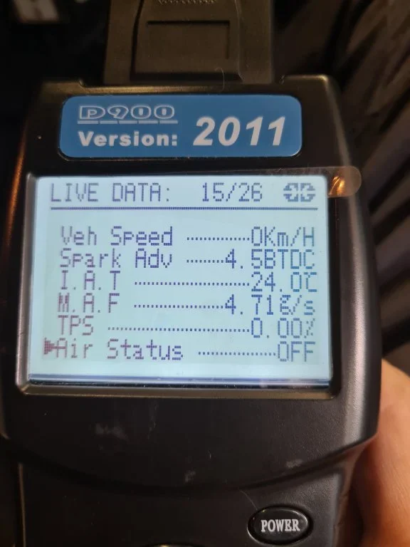

I've checked the codes and got 4 p0171 p0174 p1083 and p1085. I've cleared them then gone for a drive about and after about 10 minutes or so the same codes return.
I took some pic of the live data that my reader gives that are attached.
My knowledge and understanding of these things is very poor but maybe someone might understand what is going on better.

STFT at 27 certainly point to a lean running condition as the others have already pointed out. Their advice to smoke test it is the best way forward, that will reveal the problem areas, split or holed vaccum hoses are the usual cause, allows unmetered air in and this is picked up by the exhaust sensors and fools the car into thinking its running lean. When it sees this it will add more fuel at the injectors to richen the mixture, it will continue adding fuel until it realises it can't correct the situation, it lights the EML up at this stage to draw attention to it and sets the codes you are seeing. It will add up to 20% more fuel until it realises its not working. Your mpg will drop dramatically when its got this problem, Do check the back lower edge of the inlet manifold for any missing rubber blanking plugs, they split and fall off, being where they are they are often missed on visual checks, smoke will find them if they are missing.
In the past I have found the plastic cam cover on a 2.2 had started degrading and had started splitting and crumbling around the No4 spark plug well, smoke test found this, fitting a good used cam cover and new gaskets solved that one. Once fixed the fuel trims returned to normal. These engines rely on a completly sealed vaccum system across the engine from Maf to exhaust, any leaks in the system will present you with running problems.
