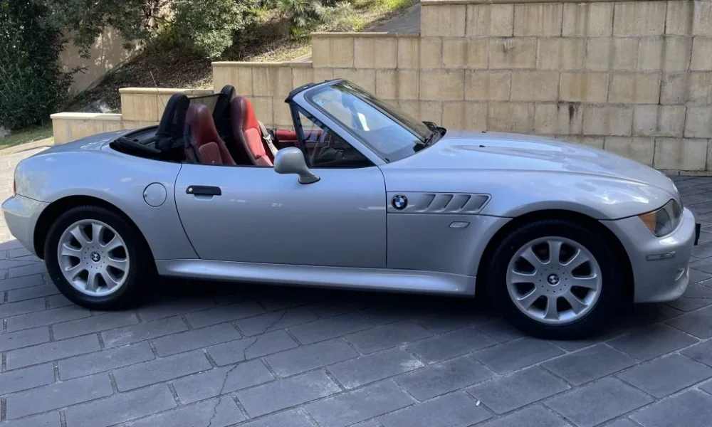

After a couple of weeks though, I did get a little annoyed by a slight shudder from time to time. I figured that it’s an old car so the bushings may be a little old. So I found a good Indy specialist. They did say, oh, that’s “scuttle shake”. I wasn’t so convinced and got them to change the front bushings. Then do an alignment. It turned out the front wheels were at Marty Feldman toe settings. 1° left 4.5° right. An alignment combined with the new front bushings was a dramatic improvement. 80% better and quite acceptable. But still not perfect.

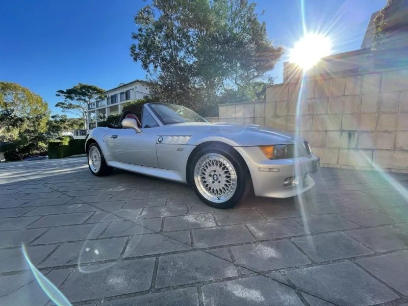

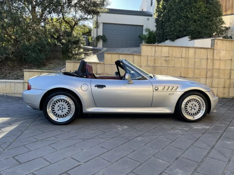

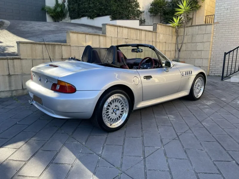

Finally I ended up with AG M220 wheels, a bit like BBS RS, a lot like HRE 501, but still a recognised quality wheel. I ordered them from an Australian dealer with a great online store. They were delivered to my door in 3 days. Fitted balanced, flawless. Also great value.

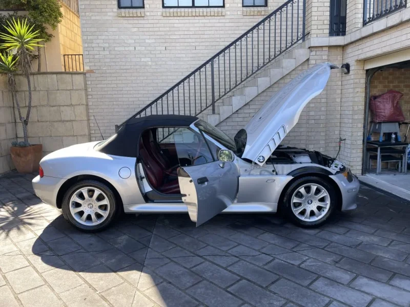

However. I wanted BMW centre caps. I googled endlessly what BMW caps to get. So much conflicting info. In the end I held the caps that came with it next to my M2CS and they appeared to be the same size. So I just drive down to the local BMW dealer and bought 4 x 68mm BMW caps. Sure enough they fit perfectly. So. If this post ever appears in some poor soul’s Google search. Take it as Gospel that the 68mm caps fit just fine on the AG M220.
So I polished the wheels today then fitted them.
They are a 17x7.5 square setup ET40. 225/45/17 tyres. Let’s face it, the Z3 isn’t a tyre burner it’s a joyous cruiser. No need to over tyre it.
The outcome? Every little bit of shudder is gone. Perhaps the old 16s had hit some potholes in their time? Also, this combo is near 3kg lighter per corner. That’s a lot! Ride, handling and steering is massively improved. It’s uncanny. Also. Bloody hell it looks good.
