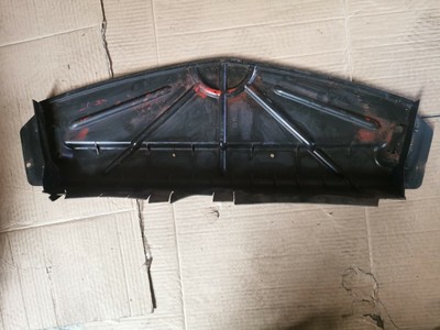

Hello can anybody help
I’ve just got a 2.0 Z3 but unlike the other six cylinder ones I have had over the years it does not have a undertray under the engine. I believe there should be one.
Has any one got a photo of the underside of a 2.0 to show what it should look like?
I have read on other forums about long and short ones confusing?

Can't help you with the remote control issues, but I can confirm that there's only one small undertray which ends right before the steering gear housing. I have no picture on my smartphone but this is what it looks like:
Thanks for your reply now I know what it looks like I will get one fitted
Thanks again
Norm

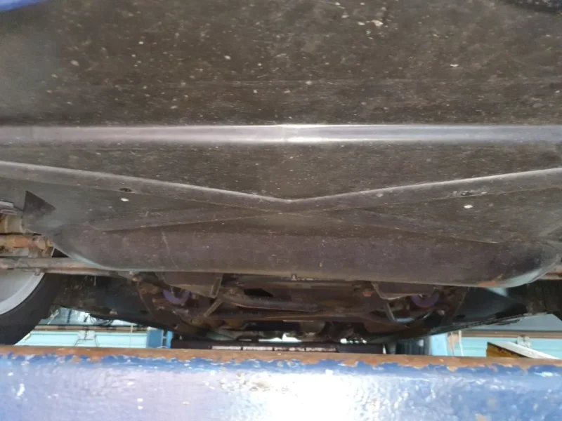

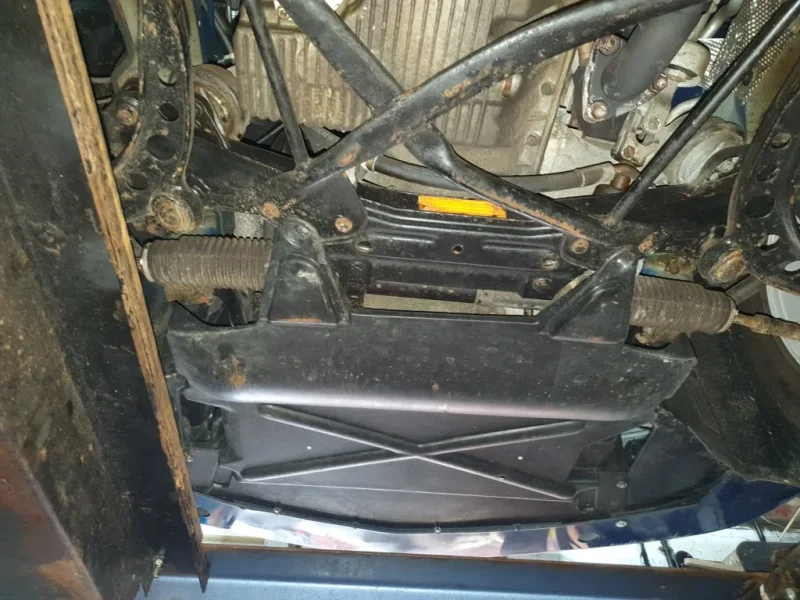

Can't help you with your locking problem but my experience with the undertray may be of interest my 3 0i had just a small splash guard in the nose, and as I live in the sticks it was as much use as a chocolate tea pot. I now have a larger tray which covers the underside from the nose to just beyond the steering rack. I don't know what model it was designed for but with a little enginuity and slight surgery it can be made to fit. On OEM it is the larger of the two illustrated. Overheating? it has been on for 11 years without problems. It is not the easiest thing in the world to photograph, but if you are interested I will try.
Hi Norm, the small under tray fills in the gap between the front bumper and the radiator(s) If with the bonnet open you can see the ground between the bumper and radiator then yes it's missing. If you see a sheet of grey foam then that's all you get on the 2.0. On the 2.2 this was extended back to the crossmember.
Hi Chris thanks for you post. some photos would be useful and any other guidance on extras & surgery required to fit
Thanks
Norm
Norm here are the pictures as promised
Cheers Chris
