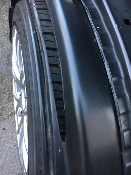

Ooh hadn't looked at that picture aswell. Yeah there is an issue there. The car as a whole doesn't look to low so like Gary says possibility worn shocks or a broken spring? Have you checked the other side to see if it has worn through?Looks a tad too low the way it's worn through your inner wings. I'd check if your front shocks are working as they should. When there're worn they don't return to full height very quickly, if at all.
Sorry GarryWake up Dave![]()
Appears to have been intentionally cut rather than worn through.Looks a tad too low the way it's worn through your inner wings
There're worn through, have a look in the crease right above the tyre on the edge of the liner.Appears to have been intentionally cut rather than worn through.
Im going to go measure the front, Ill be backNever assume!Springs are great must be shocks ,but it doesn't bounce or handle bad. I just assumed the shocks were done at the same time as the springs, but maybe not.
