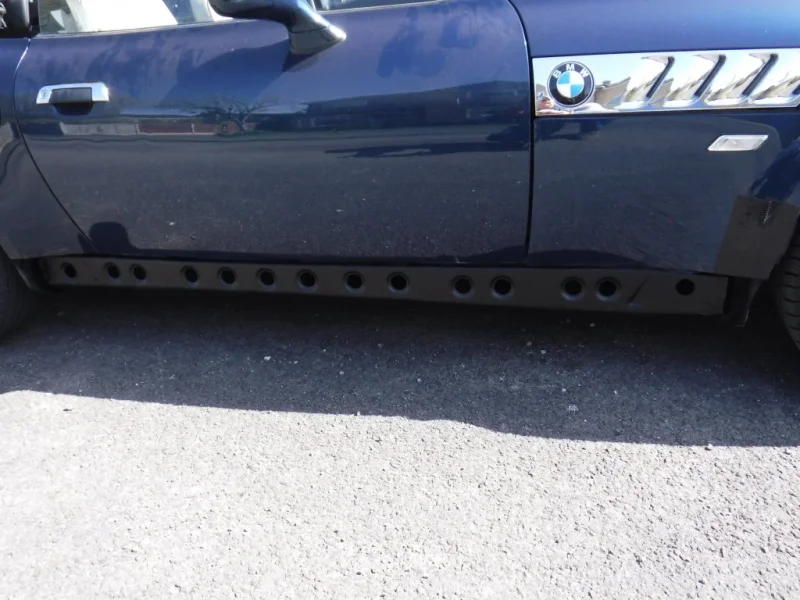

May well be worth removing the outer sills and cleaning treating the inner (structural parts) of the sills before doing the body kit. I would think it would be a much easier proposition before anything else done. Keep us posted with pictures and progress please.

May well be worth removing the outer sills and cleaning treating the inner (structural parts) of the sills before doing the body kit. I would think it would be a much easier proposition before anything else done...
+1 from me. I stripped off the rusty outer sills on mine followed by Bilthamber GE-OX, zinc-based primer, matt black rattle can and Waxoyl on the inners before the grp sills went on.
The outer sills will be removed as they are no longer needed with the rebody so the inners will then be treated. I fully intend to update the thread with progress👍

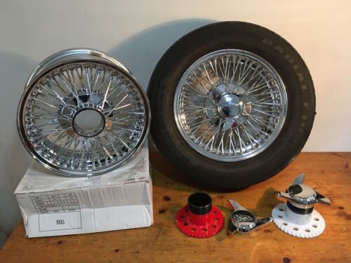

I can supply chrome wire wheels. hubs and spinners designed for the Z3 if you need a seat. Tubeless of course and you can still use the existing space saver tyre as well if you want.
How much would you charge for them?
Took mine off and found a whole lot of nasty underneath - trying to get a price for getting the welding done at the moment - those outer sills can cover a lot.

Set of 4 wheels, hubs and triple eared spinners are £1650 but can offer £100 discount to forum members.
As fitted to my 259swb in my avatar.]They use a peg lock design, not splines so will take a lot more power.
The hubs are held on with the original BMW wheel bolts so the hub can be removed at the side of the road in case of a puncture and the original space saver wheel fitted.
Would you have a photo?

jaguartvr
Jan 9, 2017
95
Here is a link to my eBay listing with photos. The wheels were designed to fit the Tribute 250swb and the DNA 250 California. I can also supply parts for the DNA California, interiors trim to a full kit.
