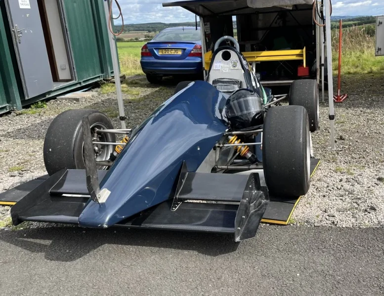

Not sure if he’ll be there, but John Bunting is always worth a chat. Comes over from Kano, Nigeria, gets the Jedi out of storage, does three weekends of Competition, sleeps in the Landrover, back to storage, back to Kano.
He did Forrestburn in Scotland, 26/27 Aug, I think he said Wiscombe was his last ‘23 event.
Nice bloke, I’m sure someone said in his 80’s now. Still bloody quick though.
