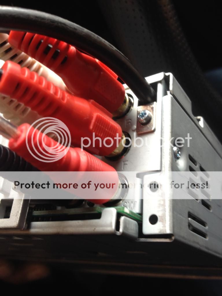

I've run new wires (RCA from sub output on the Alpine headunit, remote wire, wires from amp to sub and power wire with fuse for amp to battery and earth pints).
I've not bridged it as the sub is 4ohm.
I expected it all to play but no no sound from the sub at all. Amp is switching on.
My thinking is that there is something going on with the wiring from the headunit via the HK amp (I'm leaving that in place, just want to amplify signal to the sub for now).
The headunit already had 2 sets of RCA's running out if it plus all the other wires via the harness adapter.
Is it a case that headunit is still sending a sub signal via some of the additional BMW wiring and to make it activate the signal via the RCA I need to cut some of the BMW wiring from the harness.
Have switched the sub output on on the HU? My Alpine HU, has options to switch the sub Preout on and off
I think so - I adjusted the 'Sub Level' in the Sound menu and made no difference.
That setting worked fine via the old set up and I didn't have to switch anything on even after a battery disconnect, just change it from 0 to a higher number up to 15.

I'm running 2 amps - the new one just for the sub, the HK remains in situ for the rest. I've run the RCA direct from the HU to the new amp (+ new output wires from new amp to sub) so bypassed the HK totally (or I thought).
I'm thinking that there is a feed via the normal wiring on the harness for the sub via the HK amp. I have found some diagrams online from another forum user and will use that to track the wires down and take them out (that way the HU is sending the sub signal via the RCA only and not via the BMW wiring?). Does that make sense?

I am thinking I need to lose the original sub wiring as with it in place it seems the headunit is sending the sub signal down those 4 wires rather than the RCA outputs hence no sound at all. (The original amp and wiring is all in place just no longer connected to the sub so still connected between the HU and HK amp.)
