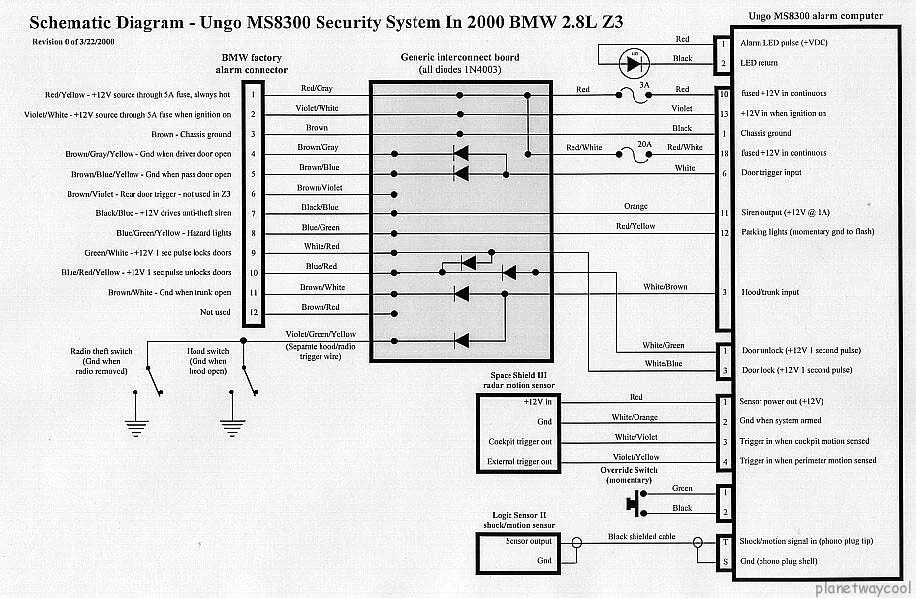

Chamber66 Dedicated Member British Zeds Joined Oct 4, 2023 Points 41 Location Swansea Model of Z Z3 2.8 Oct 27, 2025 #1 Hi does anyone have a copy of the wiring diagrams for my 1997 2.8 Especially the section regarding the alarm? Tia
Rudyrov Zorg Guru (I) American Zeds Joined Jan 29, 2014 Points 95 Location Phoenix, AZ Model of Z 2.8 L Roadster Oct 27, 2025 #2 Basically all I have on it. Attachments schemati.webp 106.7 KB · Views: 398

Chamber66 Dedicated Member British Zeds Joined Oct 4, 2023 Points 41 Location Swansea Model of Z Z3 2.8 Oct 27, 2025 #4 Rudyrov said: Basically all I have on it. Click to expand... Thank you
