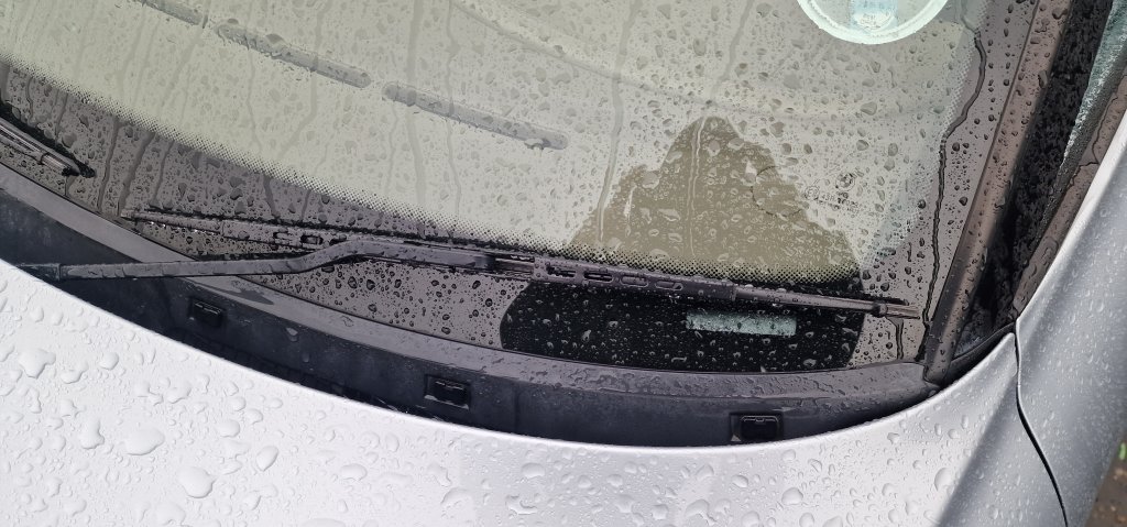

I also don’t recommend driving a Z3 in the rain🙃.View attachment 329795
Yes. I bought some if these from BMW a couple of years back. They are specified as 500m, which converts to 19.68 inches (aka 20 inches in old money). 475mm (i.e 19 inch) would also work.

The blade (aerofoil piece) should be fitted so that it is below the wiper blade. This is not always made clear in the fitting instructions and may not seem logical particularly if there is a 'universal' fitting to the arm. It took me a while to work out how to fit the BMW OEM ones.
