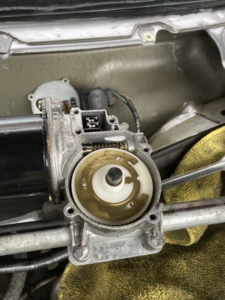

Did the annual grease removal of the wiper motor disc today as wipers not parking correctly. Not a lot of grease on the disc but some what looked like corrosion?
Cleaned disc but had to revert to a blade to remove corrosion. Wipers now park correctly but:
Intermittent works fine
When set on slow speed only works intermittently
When set on 2nd speed (Fast) only works on slow speed?
Have disassembled twice making sure everything was clean and the terminals in correctly yet still it has the issue?
Could it be the scratch marks on the copper disc or just coincidence the wipers are playing silly and its something else?
Any ideas Zedders?

I would try some fine wet&dry paper on the scratches Paul. A smooth surface will give a better, consistent contact. Also some contact cleaner on the electrical plug can’t hurt Even if you haven’t had it apart.
Cheers Tony, will give it a try tomorrow
Hope you get to the bottom of it mate. I think the electrical connector could be the key.

Did the wet and dry, cleaned the electrical connector built back up still the same.
