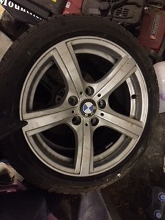

The code on the rims is : 8J17 EH2+ IS29
All 4 rims are the same size
Tyres 225/45 R17 94V Bridgestone Blizzak
I'm having problems uploading a picture but I think they are style 290

They will stick out approx 17mm over a stock 7.5j et 41 z3 rim on the front may be a touch too much fitting one would be the best bet .
