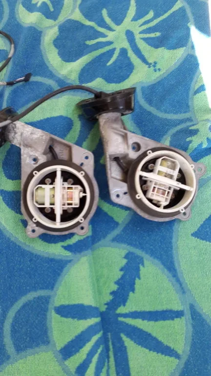

    After deliberating whether to repaint the bases on my mirrors, I finally bought the plastic replacement from here www.spiegel-z3.de, the pair painted Cosmos Schwarz were €236 incl P&P and new gaskets 51167001040 + 51167001039 were £9.60 from BMW.
    Following on from the guide on here for removing the mirrors... https://zroadster.org/articles/bmw-z3-mirror-base-refurbishment.66/
    - by coincidence that was written by R37 (Dan) on here, who I bought my car off.

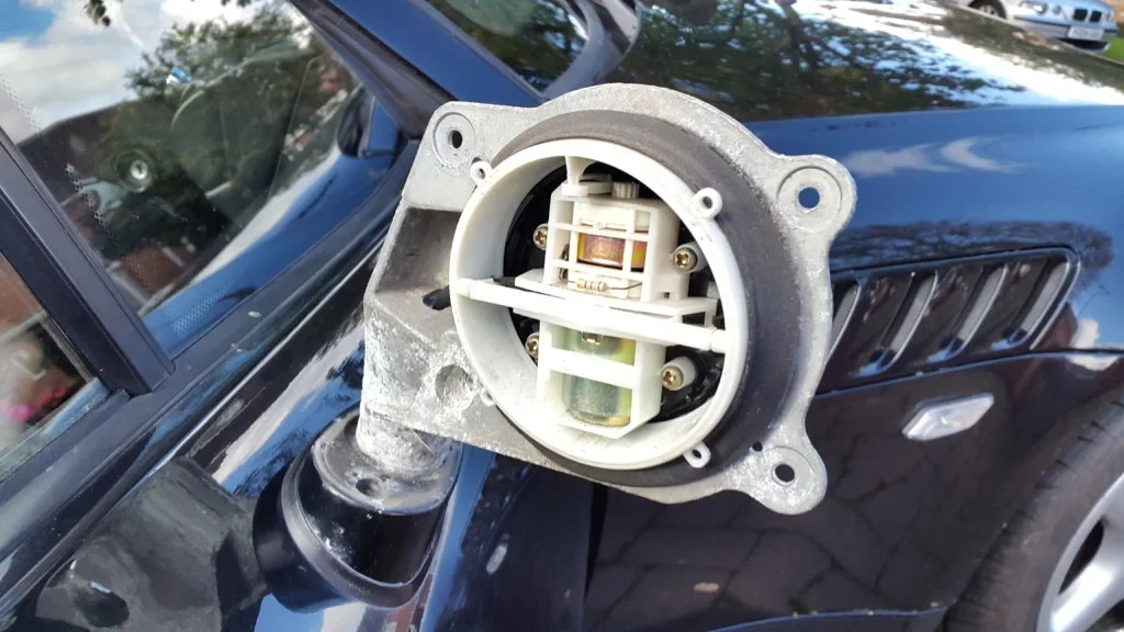

    Bases showing their age
    Mirror prised off and casing removed
    Base removed using T25 hex
    Prise apart the connector, don't hold back - they will separate
    Remove the mirror motor using & thread the connector and cable through the base column
    Rethread the connector through the new base and secure the motor to the replacement mirror housing
