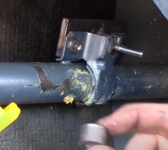

Morning all... as part of my Z3 ongoing investigations, the Driver's window has been sticking at the halfway point tipping the window slightly downward...yesterday I noticed the bottom brack post is broken which I reckon is the cause... anyway.. I found a guy on Youtube that had exactly the same issue.....and this was his neat solution !
Where the post has snapped off, he made up a bracket that utilises the two holes either side of the broken post and used spacers as a new post
